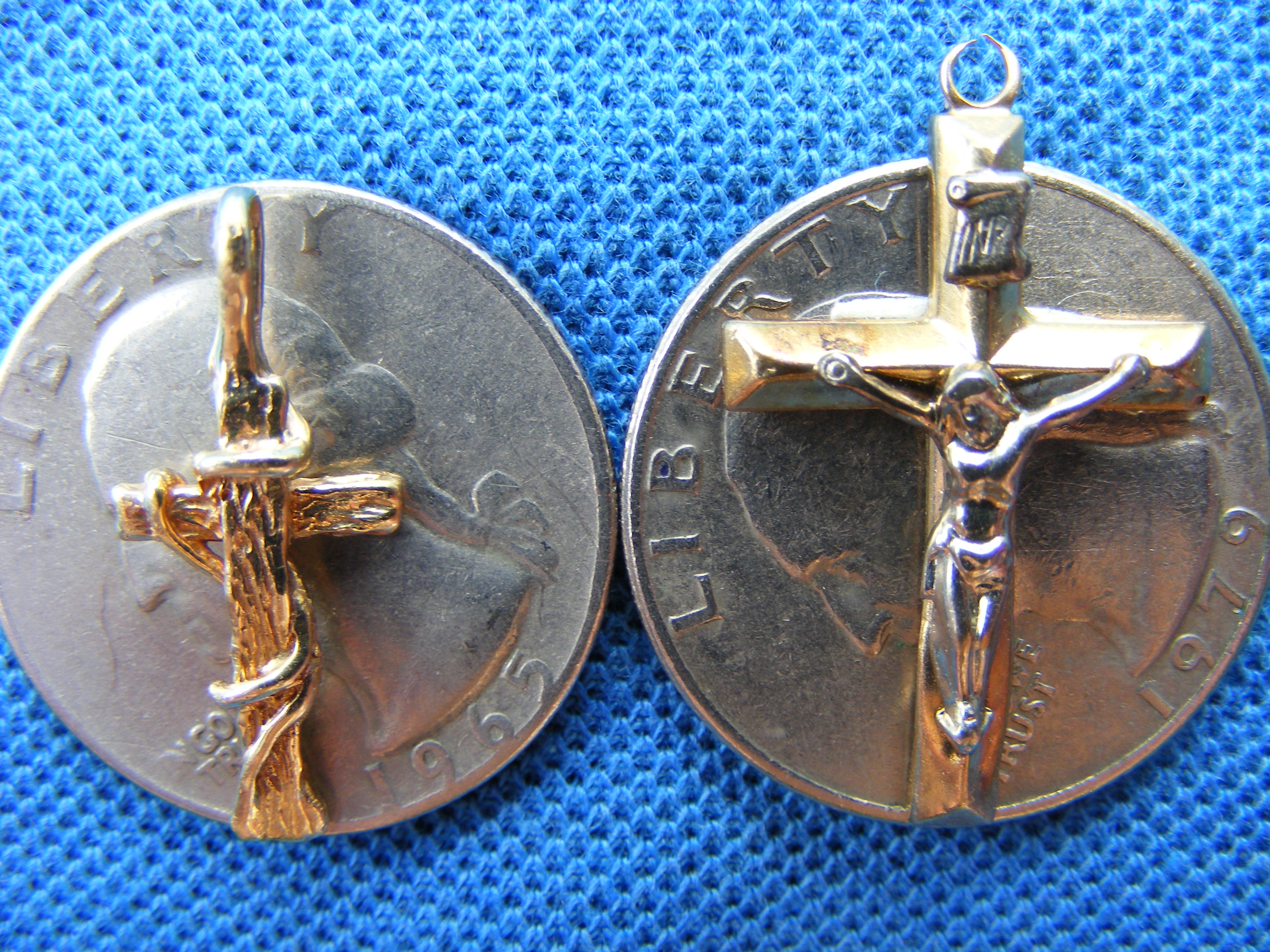

Okay. Here's where "Wet Salt Training" is critical to those of whom are truly SERIOUS about beach detecting. It is also a financial gold mine of tremendous opportunity for Mfr's......should they feel the need to heed. . . . . or.......at least, acknowledge.
In the link below...... you will find two gold crosses.
Gold cross on the left: 18Kt solid
Gold cross on the right: 14Kt hollow (it's as tall as a half-dollar)
A correctly tuned CZ will NOT detect either cross whilst in 'SALT' mode. Air-test OR on the wet salt sand.
If CZ is NOT in the 'SALT' mode....(((this means 'normal'...or 'enhanced' mode for CZ-3D))):
It will detect the 18Kt solid cross to a depth of 3.5"......both modes (all-metal and ID modes).
It will detect the 14Kt hollow cross to a depth of 2.5"....both modes (all-metal and ID modes).
Minelab Explorer/Excal/Sov will NOT detect either cross ....... with these crosses laying flat on the surface of wet salt sand.
Gold Bug-2 will detect 18Kt solid cross to a depth of 7" in dirt or dry sand.
Only detector in the world (thus far) that will find either cross in the wet salt sand.....is the AquaStar-II......a unit custom-made by a guy of whom no longer produces these units. ((( This is where a 8uS - 9uS pulse delay is crucial ))).
IF FOLKS ONLY KNEW........how many of these types of targets (of which NONE of them have ever been recovered........only to just continue to accumulate) are on our beaches/oceans/swimming-holes/lakes. Gold crosses is a good example..........NEVER to forsake pendents, charms, earrings, bracelets, toe rings, anklets...........etc....................
More to follow.
Use this link below:
[www.dankowskidetectors.com]
Tom

Likewise with my experimentation with the Sov in Disc. on wet salt sand. Disappointing to say the least. I get better results with my Aquasound, but I'm still having a hard time hunting with this concentric coil after using a DD for all these years. You have to practically scrape the sand to hear the deep targets especially with the land coil.
Tom, when you said your Sov/Excal can't hear the gold even laying on the sand, did you mean in Discriminate mode? Reason I ask is because I can detect MOST small gold I test at least down an inch or two in all-metal, even with the S12. Are your results different?
Glad to see the Salt Training is continuing to 103. Thanks Tom.
Re: CZ owners - Salt training 103
August 16, 2010 06:05PM
The Sov & Excal..............and don't forget.....the Explorer. Tested in BOTH all-metal mode and in ID mode. Yes, the Sov/Excal are a bit more sensitive in all-metal mode...........but still not enough to detect these two crosses.
