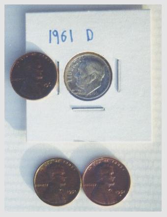

Coins found using 5 inch and 8 inch coils
These coins were found using the CZ6a metal detector with first a 5 inch coil and then changing to an 8 inch coil. The 5 inch coil retrieved two of the coins at 8.5 inches, the 8 inch coil increased the depth searchable to 10 inches and two other coins were retrieved. The coins date from 1950 to 1963.
