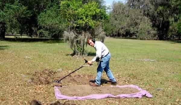

Thomas Dankowski excavating a pit to
mechanically remove ferous items. Photo by Glenn Limings

First evolution; turning off the metal detector, then spreading out a 8-feet by 9-feet old bed sheet next to the localized area of interest.
Next would be to use a regular-grade large shovel. A 5-feet by 5-feet pit would be dug; incrementally. First, the top 2-inches of topsoil would be removed. This would remove the grass and associated grass roots. Detecting this 2 inches of topsoil yielded nothing…… as to be expected.
Now, things start to get interesting. Sweeping the coil in this 2 inches deep pit (5-feet x 5-feet) yielded absolutely nothing. No non-ferrous targets. Only the continuous low-tone ‘machine gun fire’ audio output. This is somewhat of a surprise, as there should have been one or two non-ferrous targets ‘starting’ to come to light….. electronically, by detection. Not so. Sweeping a fairly large magnet in this 2 inches deep hole yielded nothing; not even iron oxide (rust) flakes.

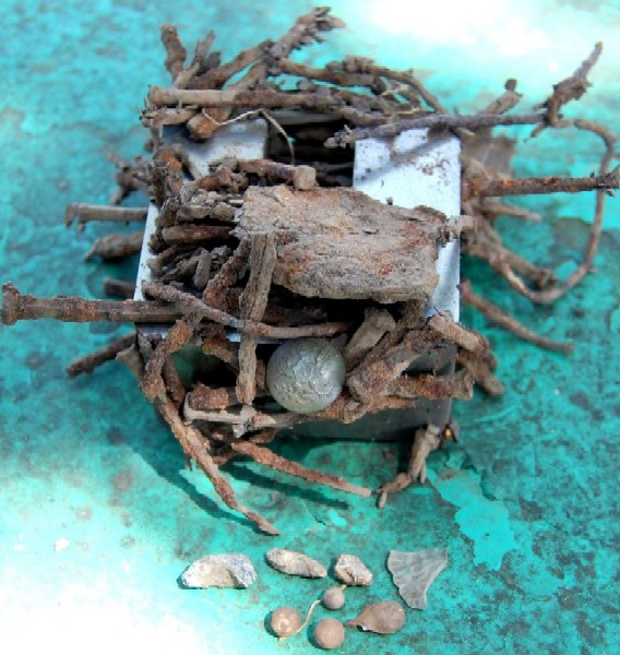

Next, would be to dig down to about the 5 inches depth mark…… removing/excavating the dirt and placing it on the old bed sheet,,,, then spreading it out evenly over a large area. Now……… sweeping the coil over the excavated dirt on the bed sheet……. would result in many iron reports…… yet, ZERO non-ferrous targets reported (remember this). Then, sweeping the coil in the dug pit…..and STILL no non-ferrous targets. This is quite unusual. Sweeping the magnet in the pit yielded 2 nails and many rust flakes. Now, , , using the detector and the magnet, the next logical sequence of events would be: to remove ALL iron items in the excavated dirt on the bed sheet. . . that was evenly spread/distributed and approximately 1 inch deep with excavated dirt. Approx ten square nails were removed…… and a fairly large volume of iron rust flakes were extracted. This is a difficult process, as the detector needs to be placed in the all-metal mode….. and each iron item must be located and magnetically removed. The large magnet is fairly powerful; yet, it is a requirement that the iron targets must be ‘touched’ by the magnet in order for them to be picked up. Continuing to sweep the magnet through the dirt…. and some of the targets that were stuck to the magnet could easily break free and be lost in the dirt again; hence, the difficulty of performing this entire evolution. Utilization of a fairly fine-screen sifter was proven to be a feudal attempt, as the nails would somehow manage to vertically slip through the screen….. including nearly ALL of the iron rust flakes; rendering the sifter useless.
Iron oxide coated iron flakes, removed using a
magnet. Photo by Glenn Limings
Now, painful and shocking ‘education’ starts to happen. Sweeping the coil over the 1 inch deep iron-free dirt on the bed sheet…. and 2 non-ferrous targets are NOW (finally) detectable. One was a .20 Cal lead BB…. and the other was a sliver of lead (appears to be a badly deformed/hit buckshot ball). With the bed sheet dirt only approx 1 inch deep…… it is hard to believe that these targets were NOT detectable…. before the iron was removed from this shallow dirt on the bed sheet.

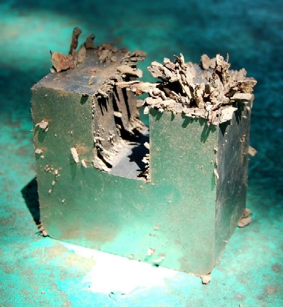

Continuing to dig the 5 feet by 5 feet pit…… another (approx) 4 inches more of soil were removed and evenly & widely distributed on the bed sheet. This brings the pit to nearly 9 inches in depth…… and also brings the bed sheet to approx 2 inches depth of dirt. (((Remember, the bed sheet size is approx 8-feet by 9-feet….much more surface area vs. the 5 feet by 5 feet pit; hence a ‘thinner’ depth excavated dirt pile))). The detector would only report a continuous iron tone extremely rapid machine gun fire audio (very, very fatiguing); and……once again……..NO non-ferrous items on the bed sheet. Utilizing just the magnet through the dirt…… then the detector and the magnet in concert, yielded nearly 30 more nails and a countless volume of little slivers of rust flakes. Now, (SHOCKINGLY) switching the detector over to the ID mode and sweeping the coil over the shallow 2 inches deep bed sheet dirt that is now sans iron/ferrous….. and the bed sheet dirt reported MANY non-ferrous targets. RESURECTION! Finally, these masked and silently masked targets came to life. A couple of .36 Cal musket balls, several fired/splattered lead musket balls, part of a wing off of a hat-plate and a large “A” Artillery coat button circa (1821-1844).…. a bit larger than a nickel. Good thing it wasn’t the size of a penny……….. or even smaller; the size of a dime. And all of the lead items had just as much…. if not… more mass/weight than Artillery ‘A’ army cuff buttons.
Nails and other items removed using a magnet.

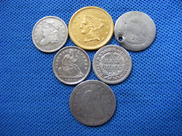

Items found at the pit excavation site area.
Photo by Thomas Dankowski
Items found at the site prior to excating the pits. Photo by Thomas Dankowski
