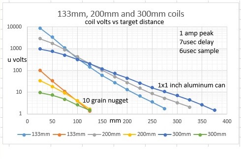

Yes, everything is based on physics..because a small coil can receive a 10..x stronger signal to a nearby target...like say an 11" coil..
A years ago I saw a very nice graph of different sized coils..on Geotech1..which pointed out this fact..That also means a small coil it10x stronger signal from a very close iron than, for example, an 11" coil...that allowed me to understand why larger coils in deep 3D separation tests still gave better results than small coils...
