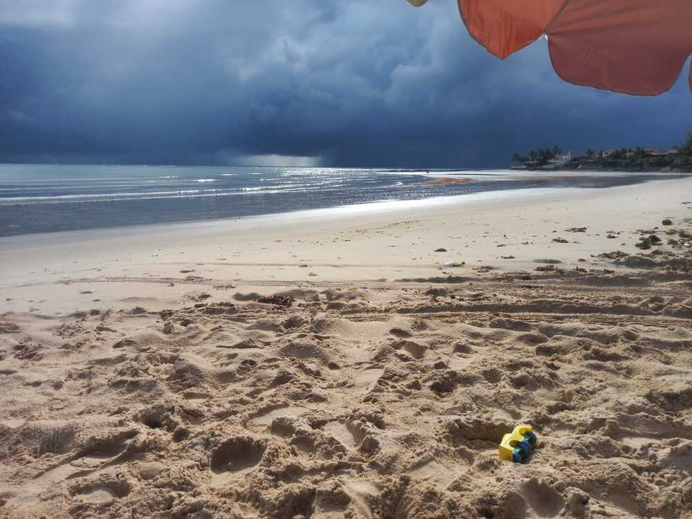

Secret Beach 2021 first year detecting
Praia "Secreta"
Praia "Secreta"
Re: MANTICORE NEW USER: BEACH SALT WATER BEST SETTINGS HELP
Beautiful photo!!!
Beautiful beach!!!
But...... the beach is so secret...... that no one is there! How could there be any losses (for you to find with a metal detector)!!!???
Yes...... the saltwater will false....with a ID of 1 & 2.
With Sens on 30..........VS...........Sens on 27 = the depth/sensitivity gain is negligible . , . , . , . especially if it increases the numbers/volume of the 'falses'.
BUT........ a Sens of 27 on Manticore..............VS..............a Sens of 21 on EQX.,.,.,.,., is a LARGE performance difference!!! With the Manticore's ability to run Sens SEVERAL points higher (over the EQX)...... you WILL see/experience a formidable performance gain with Manticore.

Secret beach is the nickname that some colleagues gave to this area of ​​Muriú beach - RN/Brazil.
In 2021 we were still in the Covid pandemic, so few people were going out. but this area has a very popular restaurant, especially among newlyweds on a trip.
And the loss of wedding rings is common.
On the day of this photo I took two rings, one 18k and the other 16k with my old equinox 800.
