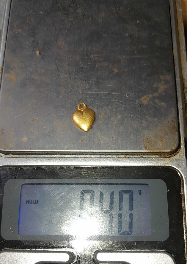

I was lucky to dig over 60 pieces of micro gold in the first 6 months.an noticed a shorter/softer sound on the micro gold..sorry I cannot explain further,it's something that just clicked over time...
2025-10-23 12-10-34.jpg (173.65 KiB) Viewed 28558 times
The little stuff: Adds Up!!! (Especially if it has stones).
Nice find!
