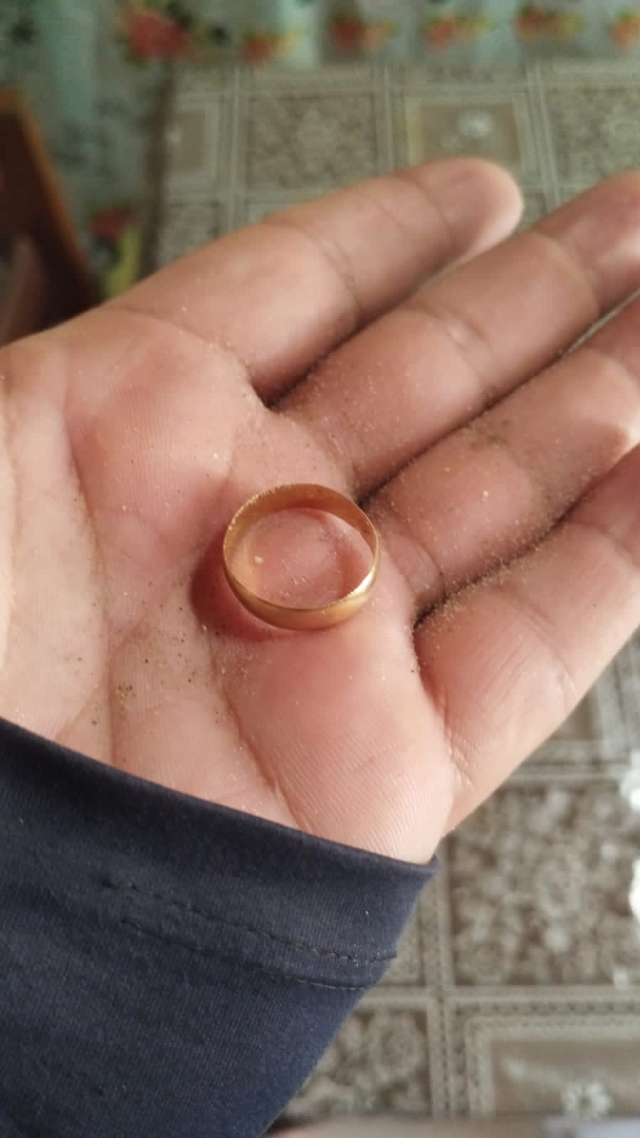

I managed to use the TOM setup with the 11" coil and sensitivity at 29 and recovery time at 5. I took a 10.82g ring
Aliança 10.82g
Aliança 10.82g
1000144340 (1).jpg (92.93 KiB) Viewed 28211 times
