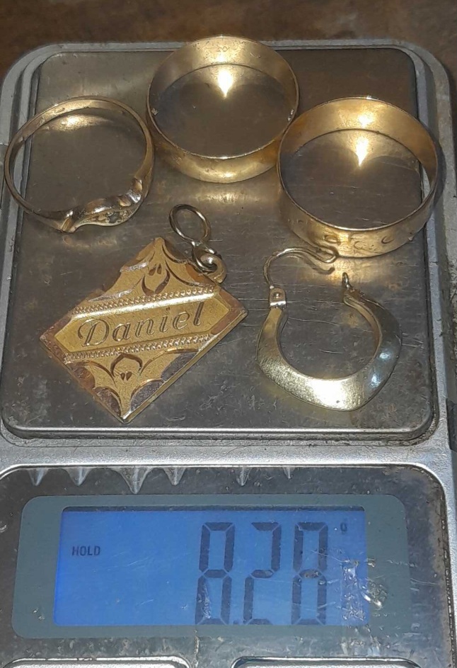

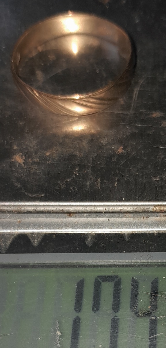

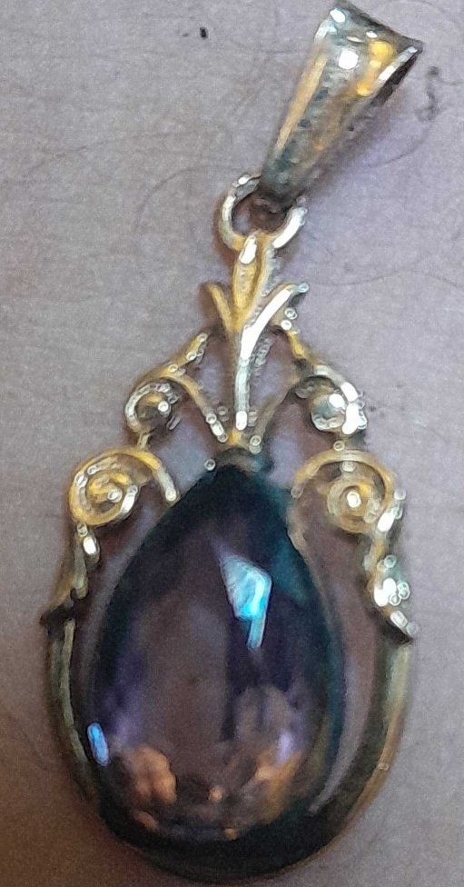

Your making perfect sense,it's just I've run ALL METAL for so long I forgot why...I'll return to my previous settings with sens on 25,this is probably adequate, imbyet to do in water testing with the M8,as itsvto cold an I'm only getting 4 hours before I turn to ice..heresvsome micro goldvfrom past 7 days with M8.

You're DOING IT!!! SUCCESS!!!!
Do NOT feel ANY bit handicapped with that smaller M8 coil.

No handicap here..I'm know throwing my 11 in the trash..haha.
every day I'm also getting 3 or 4 ,0.5g silver studs or hoops..an today a 1g fine silver bracelet..

This is stunning! Time to quit your real job!!!!

LOVE your success!!!! (And the photos)!
