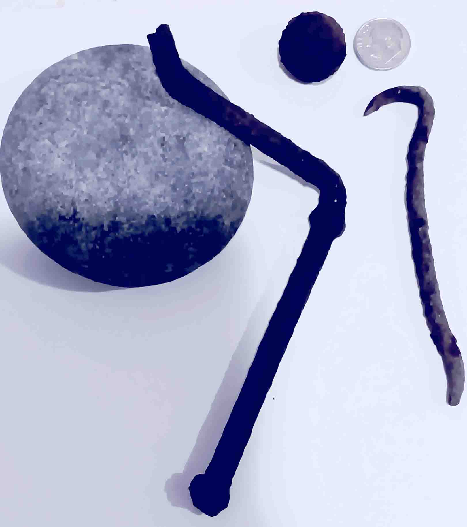

I'm not finding much non ferrous but I enjoy digging the iron in northern Michigan. In the past I have found a few Indian Heads and Barber dimes in this area. It has been hunted for a few years.
I check my shotgun shells and this is a Peter Target No. 12 with a big P that was used from 1911-1930.
The round iron looks like a musket ball. It's a little spur sticking up and is about 3/4" wide.
The iron tools I don't know what were used for. I like them though. The iron tool has a V at the end.

What I thought was a musket ball probably isn't because it's iron.

Rick..... most cannon balls (including the small ones)...... are IRON!!! But...... round-balls ...... musket balls.....(58 & 69 cal) are usually pure lead.
