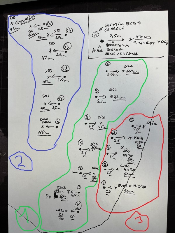

For the sake of overview, I am giving a description of the complete "Old test field" :
blue area... a bronze bowl at a depth of 110 cm and then there are Roman sestertius and Roman denarius coins at different depths..
green area... 2 x control targets of Coca Cola cans at 87cm and 100 cm, then a lead 8cm disk at a depth of 60 cm and then depots 10cm diameter ceramic containers with bronze targets placed at different depths..
red area - contains 5 iron targets placed at different depths.. serves to compare the quality of detector discrimination..
Is this test field very demanding?... yes..but that's about it here goes...
Test terrain. ES.jpg (119 KiB) Viewed 44484 times

It is your mineralization that has me very much interested in your resultant.
So far....... it sounds like ONLY the E-Trac with 13" coil .... will (somewhat) present some success.
